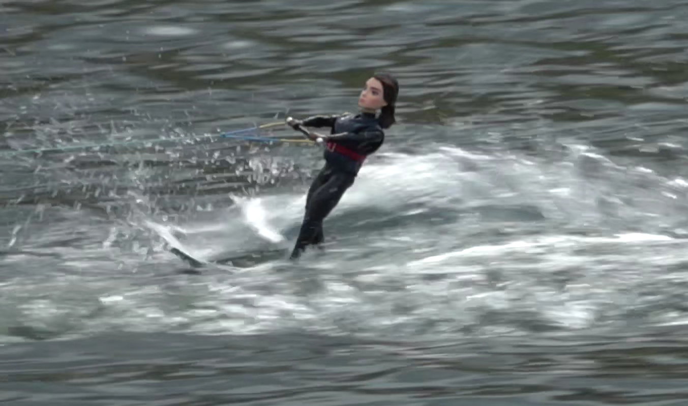

    the variable ski is in the picture she is up within a short distance but leaning left, more tuning required, I have tied a knot in both lines again this has the effect of shortening the blue tow line more than the ski pulling line because it's thicker. From the angle she is at the variable rod hasn't deployed at this point which is good, but the blue line which she holds is slack, bad.

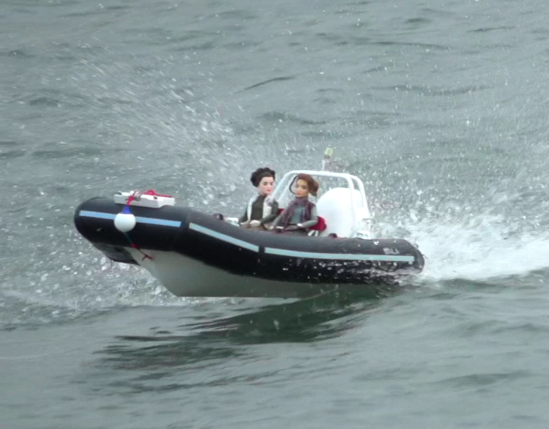

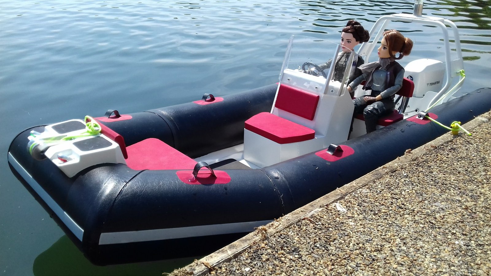

    RIB choppy water 2.jpg Thanks Dimitri, this will be my 4th rib, all have been a great success and great fun to use.

    So scale ... well done! :thumbsup:
    You can also publish your work on RIBs (and diy outboards) in your own post in this forum.
    I think many people here would be interested!! ;)

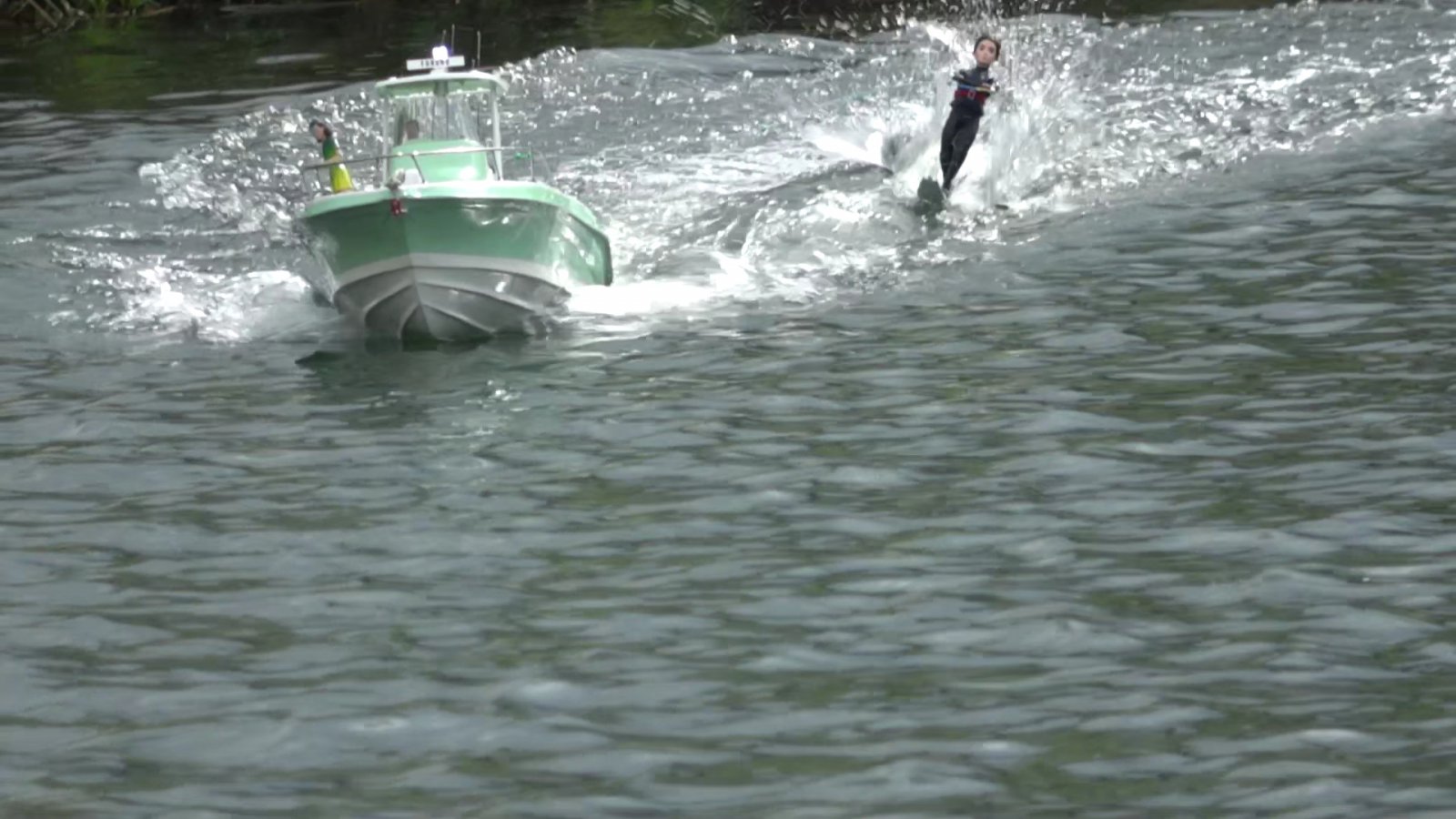

    Rey towing the ringo 3.jpg This was great fun, an inflatable scooter inner tube was used.

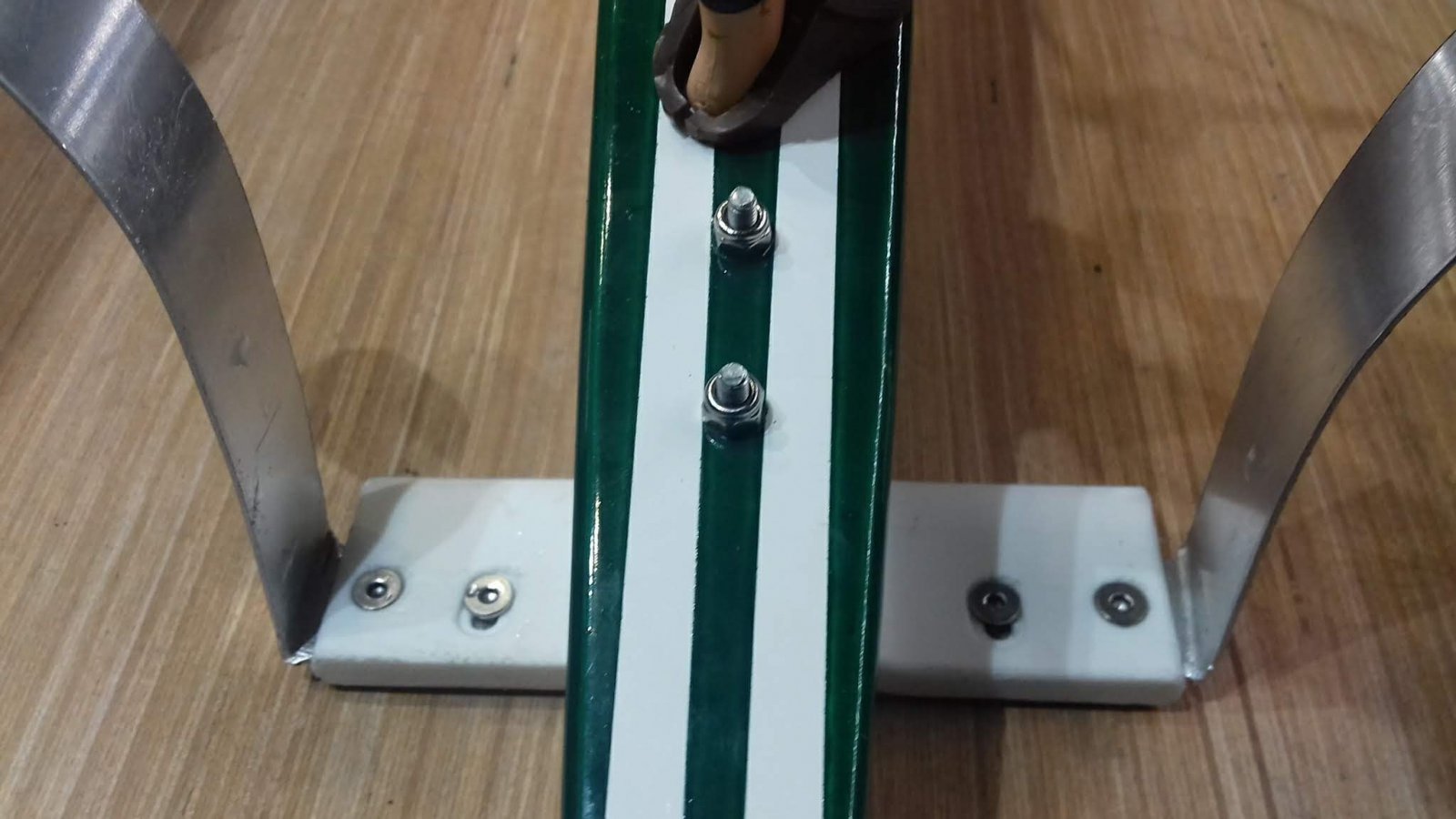

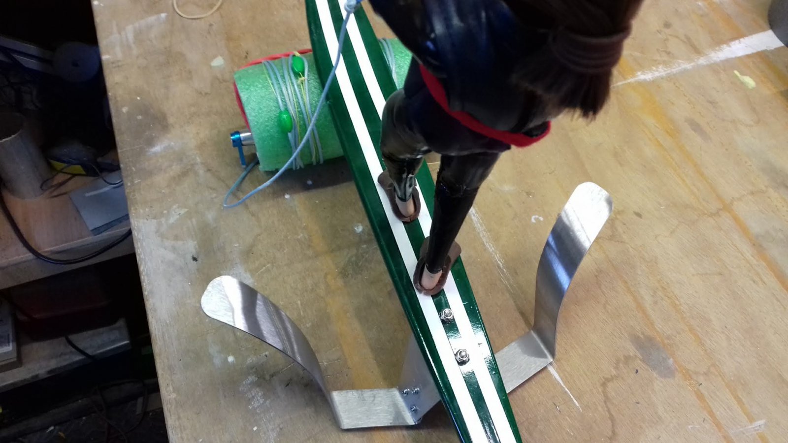

    20220408_152345.jpg 20220408_152239.jpg Stainless steel foil fitted took hours to do , trying to get each side equal, hope it works, I think it will
    Notice the fishing floats on the lines to keep away from the propeller, the most expensive polystyrene I've ever bought:eek:

    Looking good, that should be stiff enough. For the line you could also use flyfisching line. That is holow and floats on its own.

    So the stainless steel foil did work,but maybe not as reliable as aluminium. The main thing was when I put her in the lake she sank a bit deeper due to the extra weight, this spoilt the good starting position I had achieved with my ski. So need to try again to get the dural (strong ally)
    Looking at the film the tow line she holds is whipping about , I may try swapping it for the same fishing line used for pulling the ski.

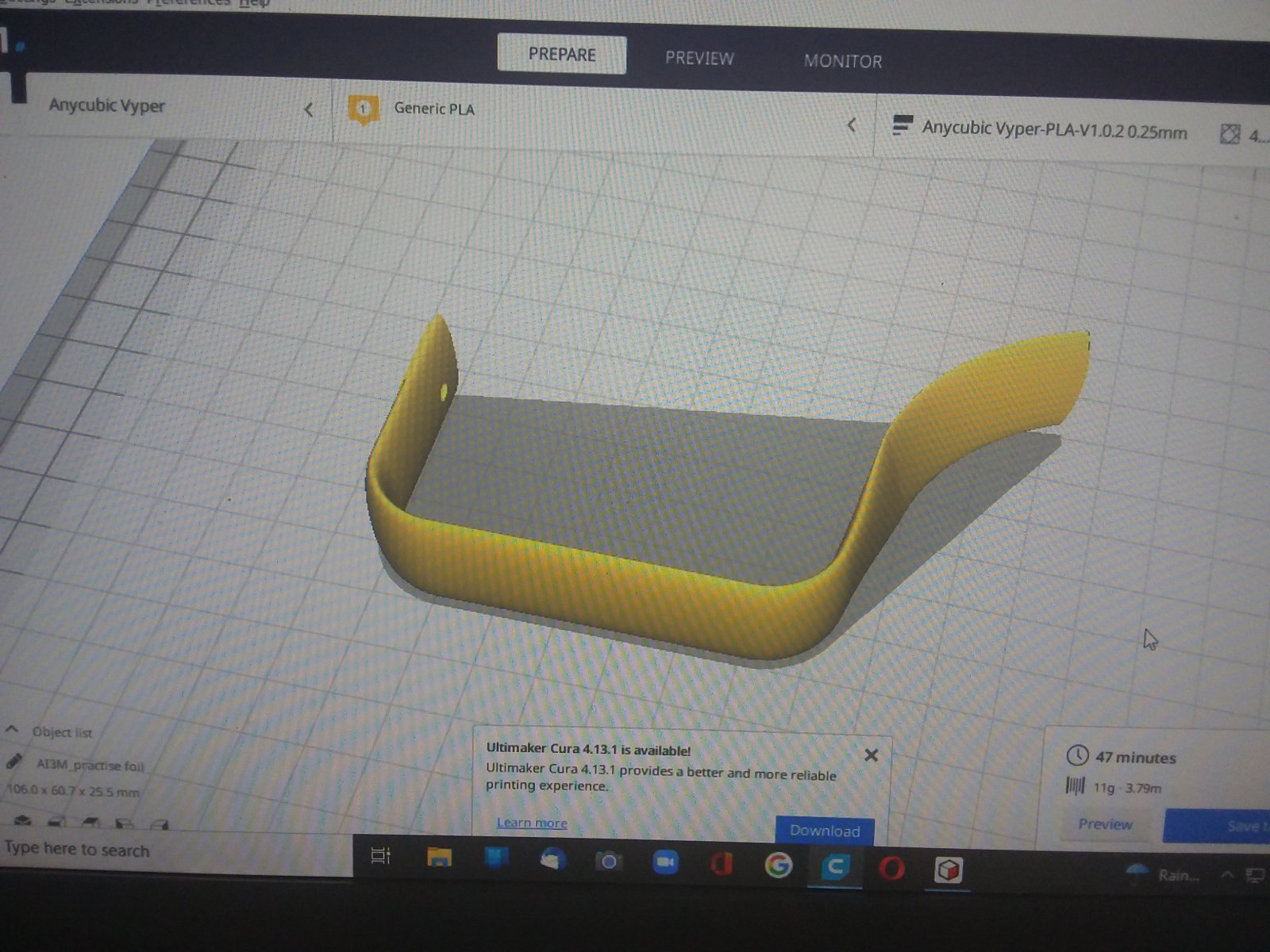

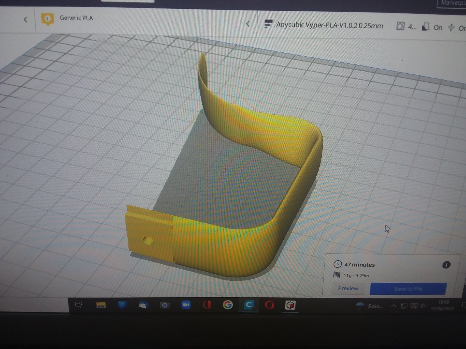

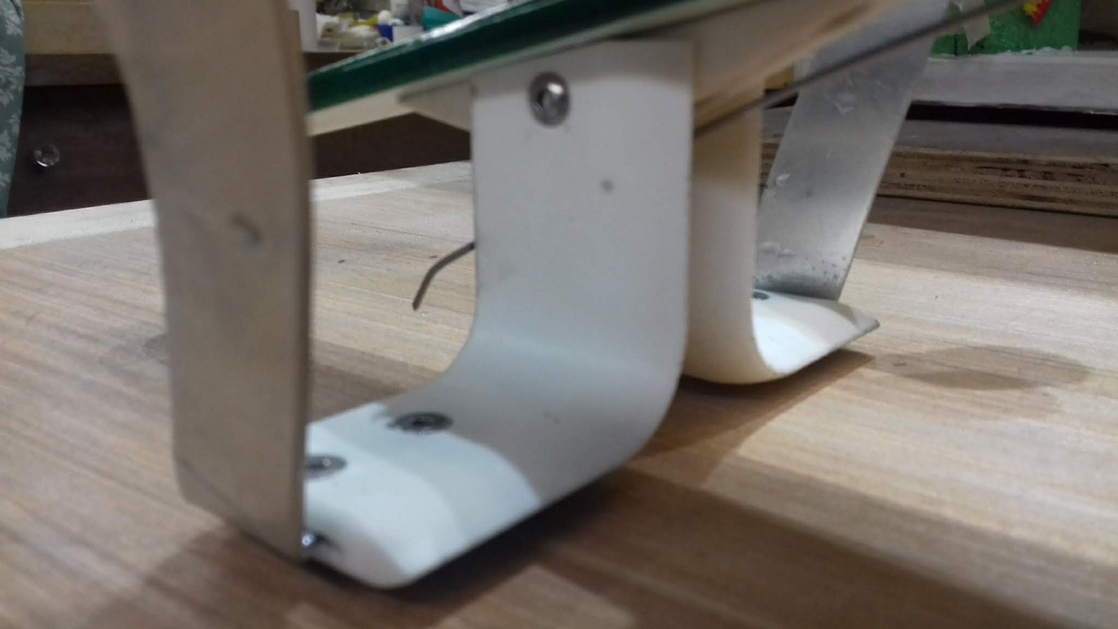

    20220412_194036.jpg 20220412_194103.jpg 20220412_194044.jpg Another try , having no luck getting the aluminium, it's now called 6082 not dural , so at least I'm on the right track. Someone at the club said why don't you 3d print the foil, so I've given it a go. Whilst at it I made the blades adjustable with two screws seen in the horizontal section. Weight wise not saved much, but I could save some more by altering the printed blades.

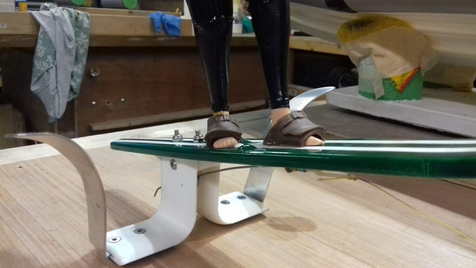

    20220413_195812.jpg 20220413_195726.jpg So it worked, did some filming. However it still bends at the join, I didn't think it possible to print a complete blade, but I've had a practice and it is possible. All guess work on the angles , but I may try and draw it for real this was a practice drawing.. I think Lex said if it is wider then it will work at lower speed. We have a speed limit near the jetty for the yachts. It's quite relaxing pulling the skier at slow speed as I found out today. Some dimentions from Lex would be helpful

    ski8.jpg ski7.jpg ski5.jpg ski2.jpg ski1.jpg Pictures from the video taken yesterday, the part printed foil worked better than I had realised at the time.
    Using the new white outboard this time, it drew 70 amps, compared to about 50 for the blue , maybe it will drop as its run in.
