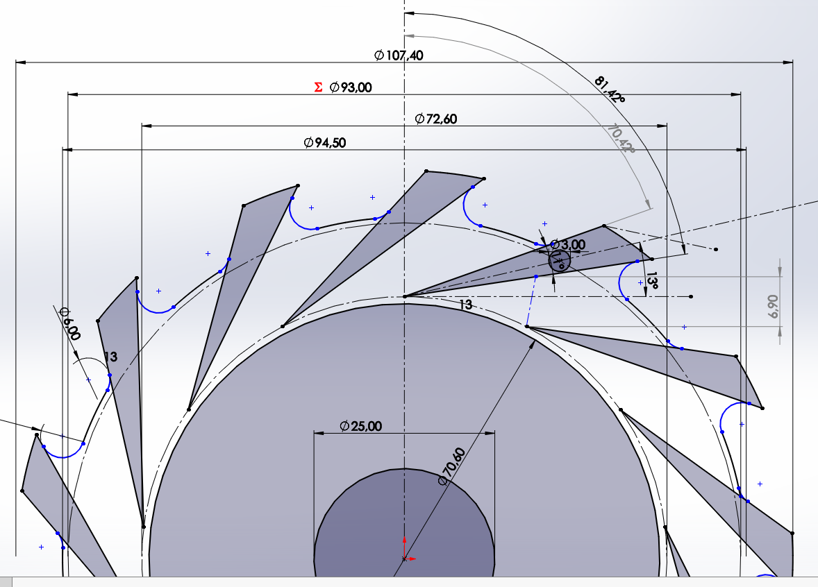

    I started to build a KJ66 from Artes, but I find later your GR130, as I have already made some parts, I'm building a KJ66 - GR130 hybrid.
    I read your modification of the diffuser to change the angle from 14 to 13 degrees is my sketch is good?
    I have bought a T04E, https://fr.aliexpress.com/item/3295..._list.0.0.6c355e5bIsSIDk&gatewayAdapt=glo2fra, looks like the same you used
    could you send me the profile file, I can't download it from your site?

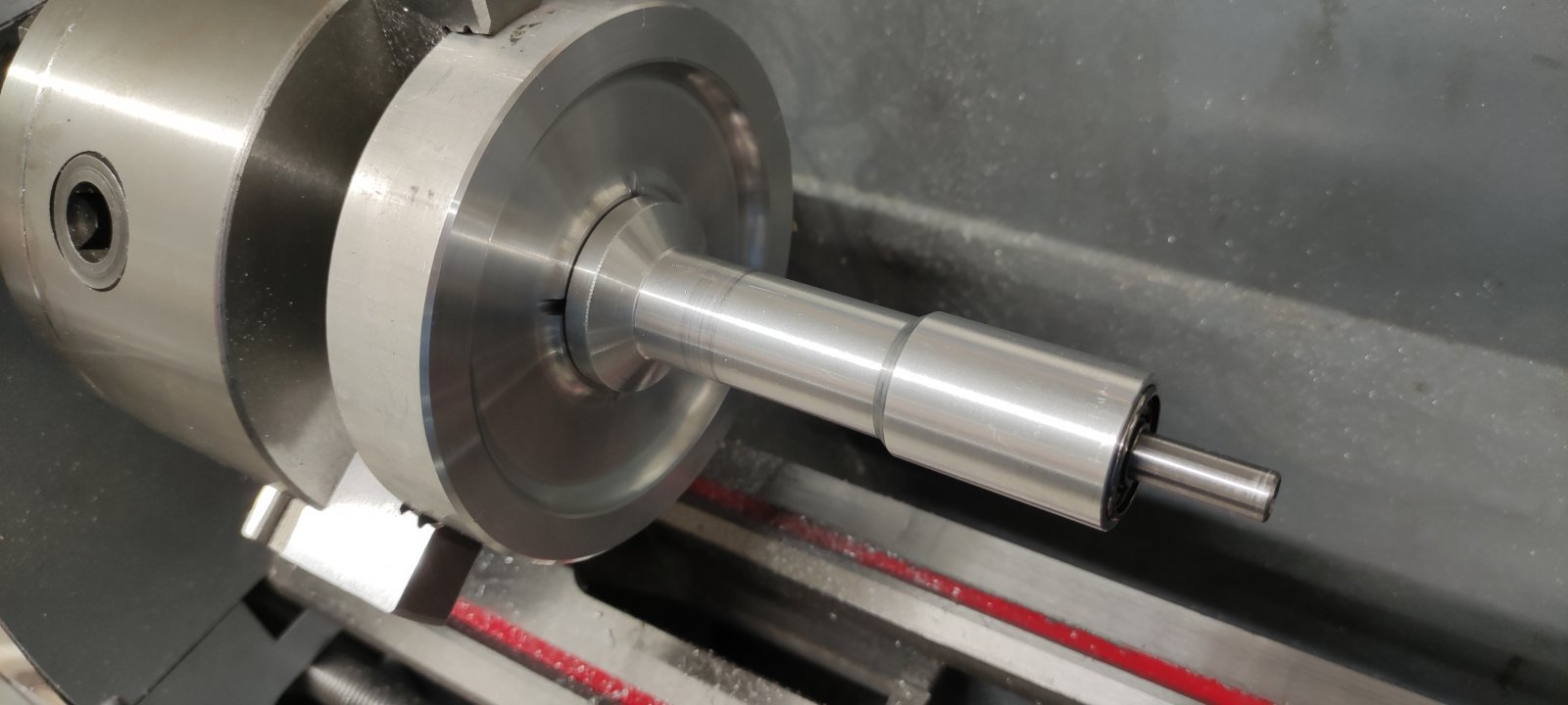

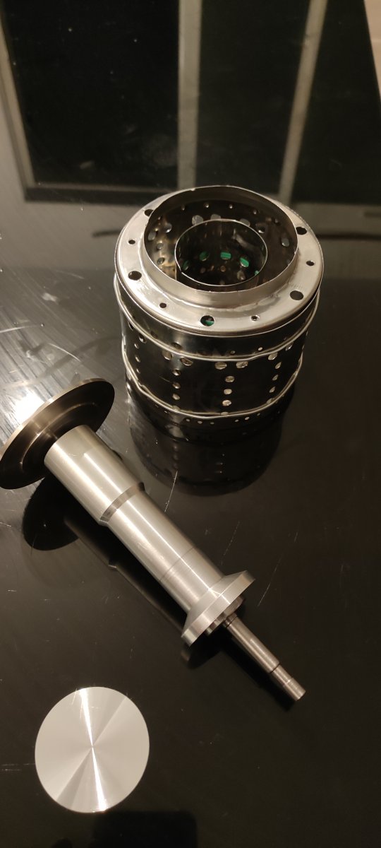

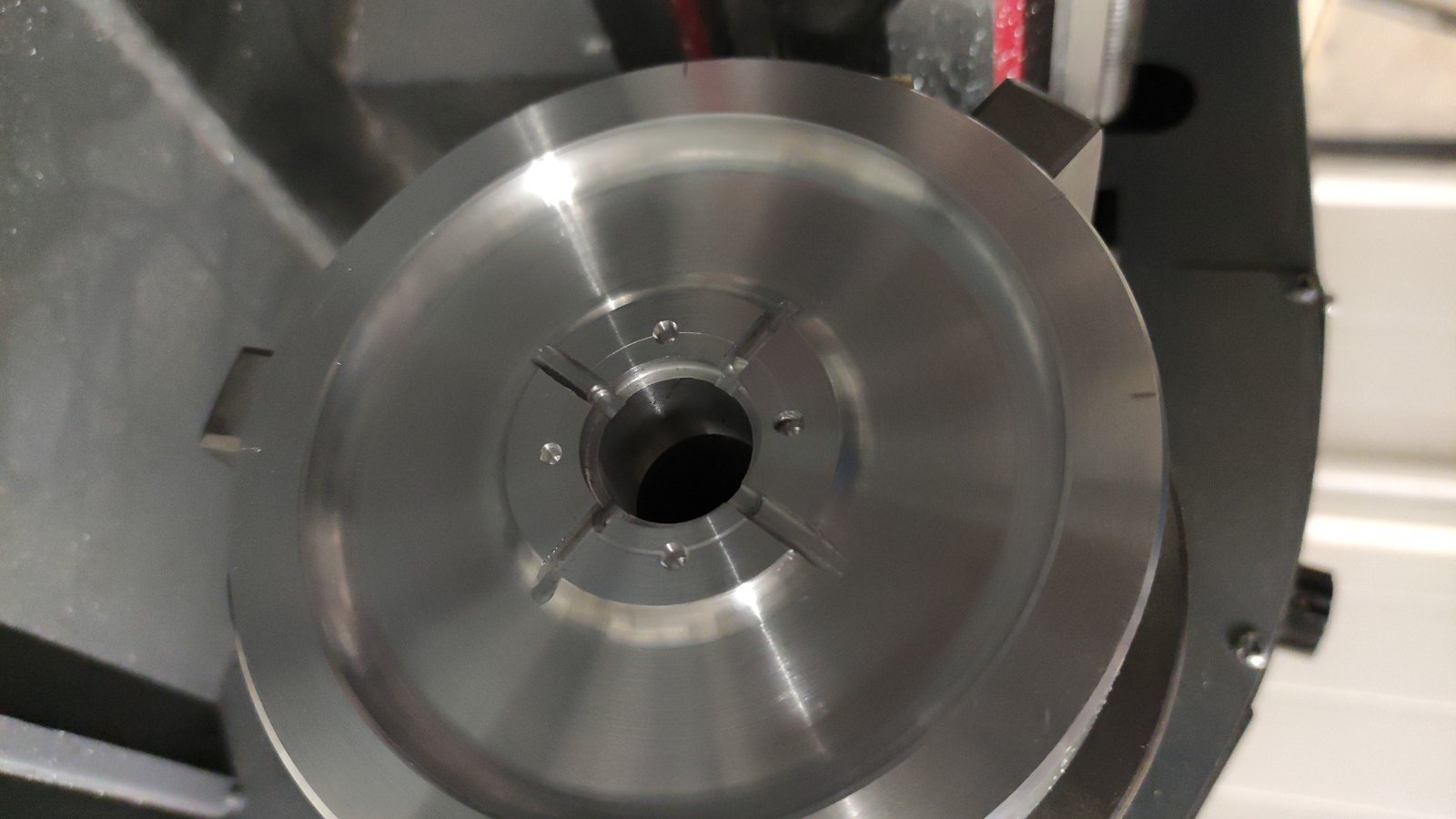

    Here is the firsts parts
    Thanks for you help
    Joachim

  8. athome
    athome
    13 okt 2016
    20
    Schweiz
    Hi Joachim
    You should change the spring in the tunnel to the front. If i see it correct, then it‘s in the back now!
    Regards Lukacs
