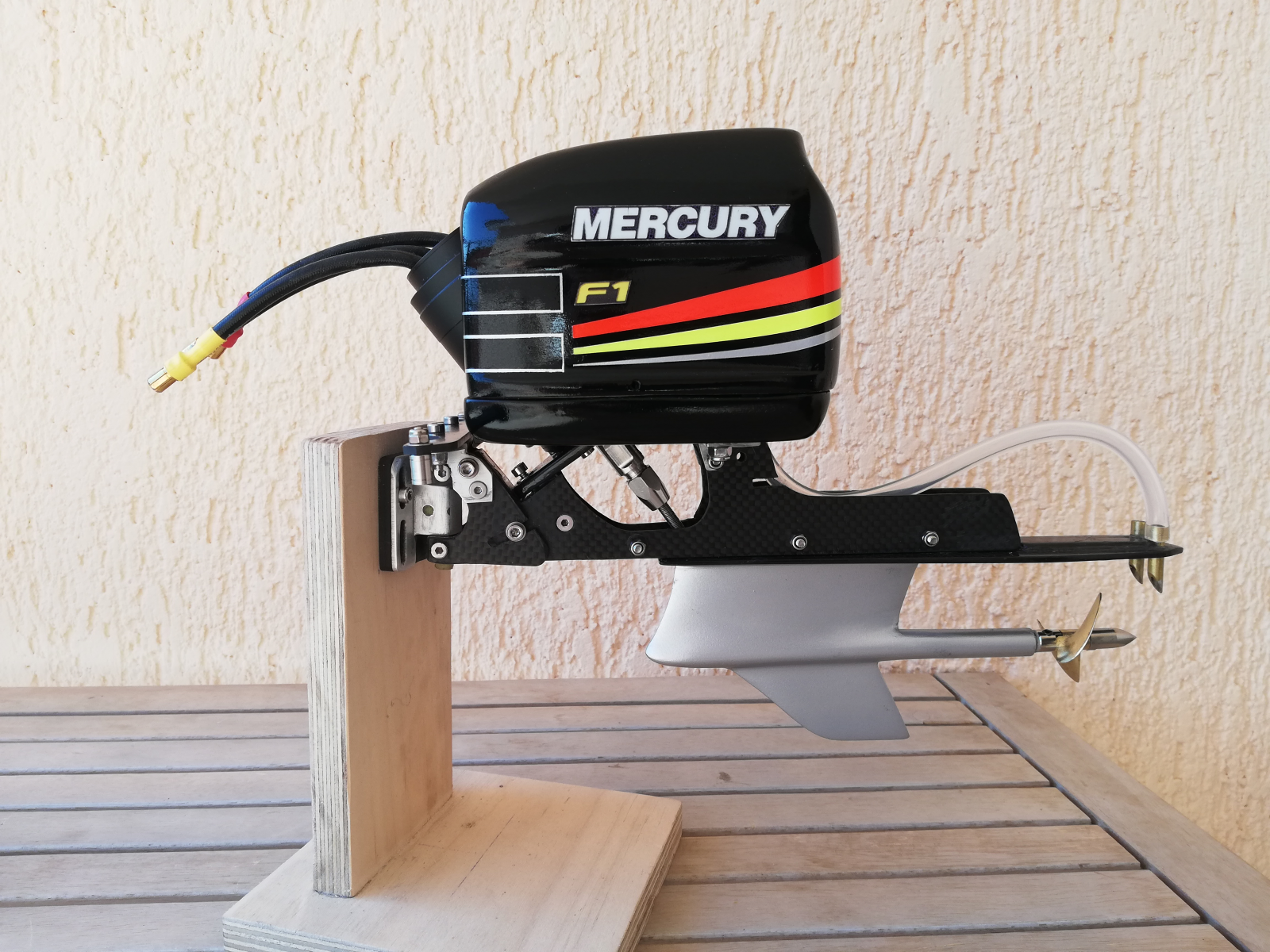

    Almost done!!
    There are a couple of things which i have to fix \ adjust but it is finally ready.
    Here is a video and a couple of protos;

    Gorgeous Dim, you have crafted a masterpiece!

    Wow looks stunning, how did you do the letters?
    Ah just zoomed in , you have cut them out from printing.

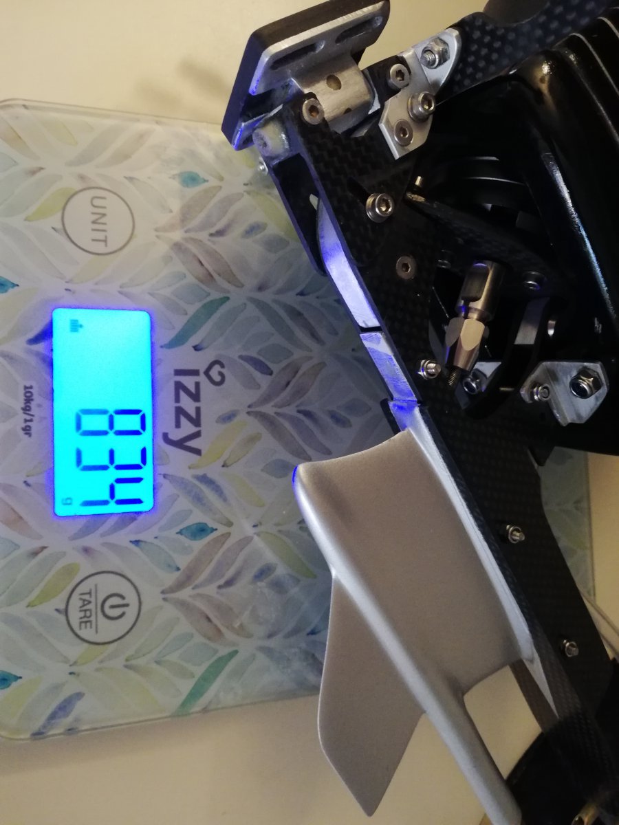

    This is going to be fast
    What is its weight?

    The weight is 834 grams with a 4074 motor and RTR.

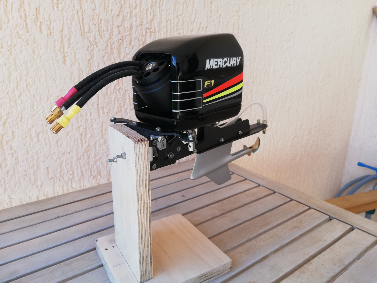

    Hi guys!
    It's been a long time since my last update.
    Finally, I tested the outboard which works really smooth. I used a 5s lipo and a 4074 1600kv MSQ motor.
    Along with the outboard I also tested my F1 hull which also run nicely and stable even if the water was choppy today. Unfortunately I have no video of the run.
    A short video of the outboard is given below.
