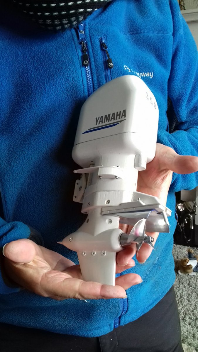

I am speechless, how can somebody just knock up a jet outboard. I have watched the Russian full size version and been well impressed. Having developed my own outboard ,prop type I know it took months of work with loads of failures as Michiel will agree. We need to see drawings and lots more info, this is exciting.

Heb je meer info over de gebruikte motor, Esc en lipo?
is gewoon een surpass hobby motor ik gebruik zelf 2s maar loopt ook lekker op 3. heeft waterkoeling in staartstuk

The concept is perfect, since bevel-gears always consume power due to the relatively high amount of friction.
Than again, true scale outboards from Yamaha and Mercury are 15% less efficient than the version with a propeller and bevel-gears.
Those use a centrifugal pump as well to avoid the bevel-gears.
The Russian development was a true axial waterjet-outboard with bevel-gears!
Wonder how that will work:
The inventor of waterjet propulsion, Hamilton from New Zealand started with centrifugal pumps, but abandoned those early for axial impeller pumps.

Zelf een aantal gratis te 3D printen waterjets beschikbaar gemaakt, en vervolgens zijn ze op Aliexpress te koop :(
Heel leuk, maar persoonlijk hou ik het bij inbouw water-jets!
Mooi dat hij trouwens SLA gebruikt om ze te printen!
