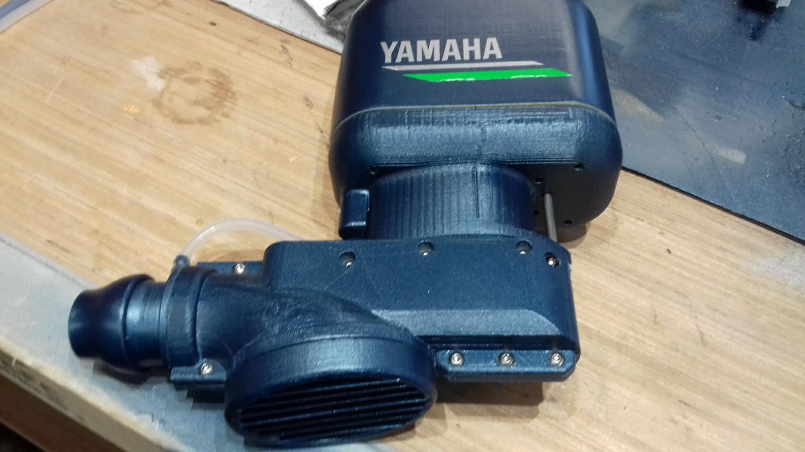

    Jet Fox
    Due to the heatwave I can't use my normal workshop, luckily I have a smaller one underneath which is 10 degrees cooler. So managed to get a bit done. It's not as well equipped so I have keep going up the steps and grabbing what I need quickly .
    Reinvented the water pickup , a tube will come from the stator and connect to the tube sticking out. 20220711_172357.jpg

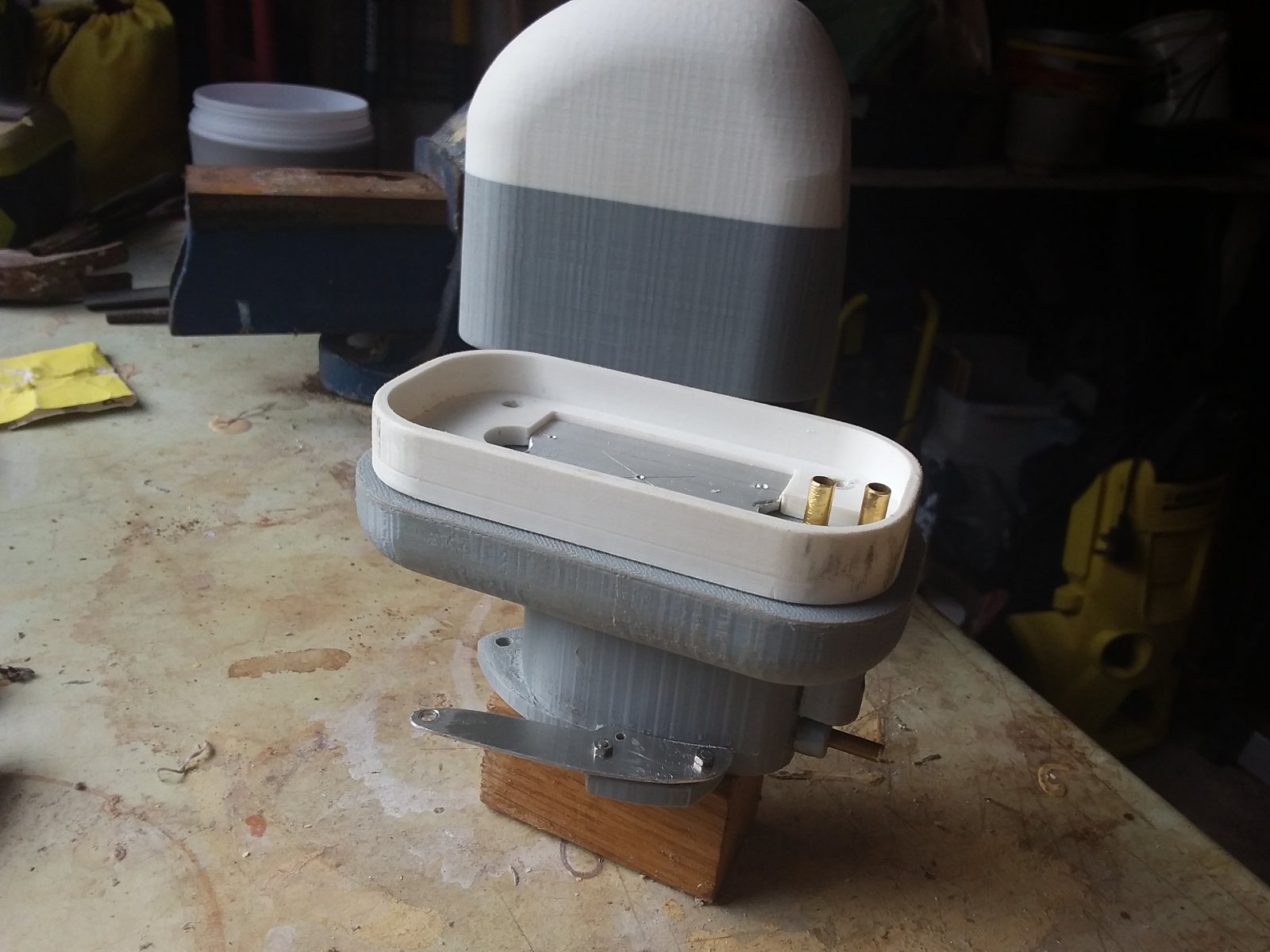

    Jet Fox

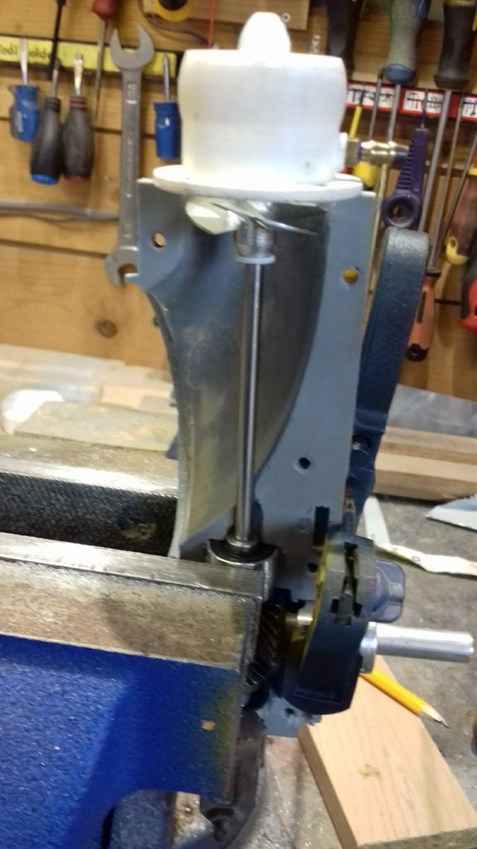

    I have jb welded all the insides to one half , so soon be able to fix the halves together. I tried Robins idea to brush cyano inside the gearbox to seal it well it worked a treat, I ruined three brushes doing it, but it was worth it, you have to get it on quick, in a minute it's dried to a glossy finish.

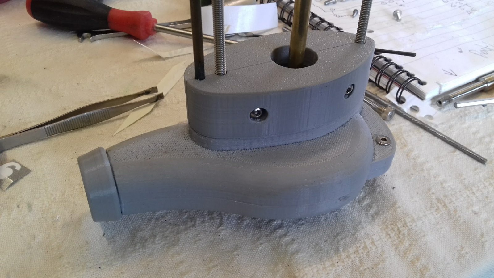

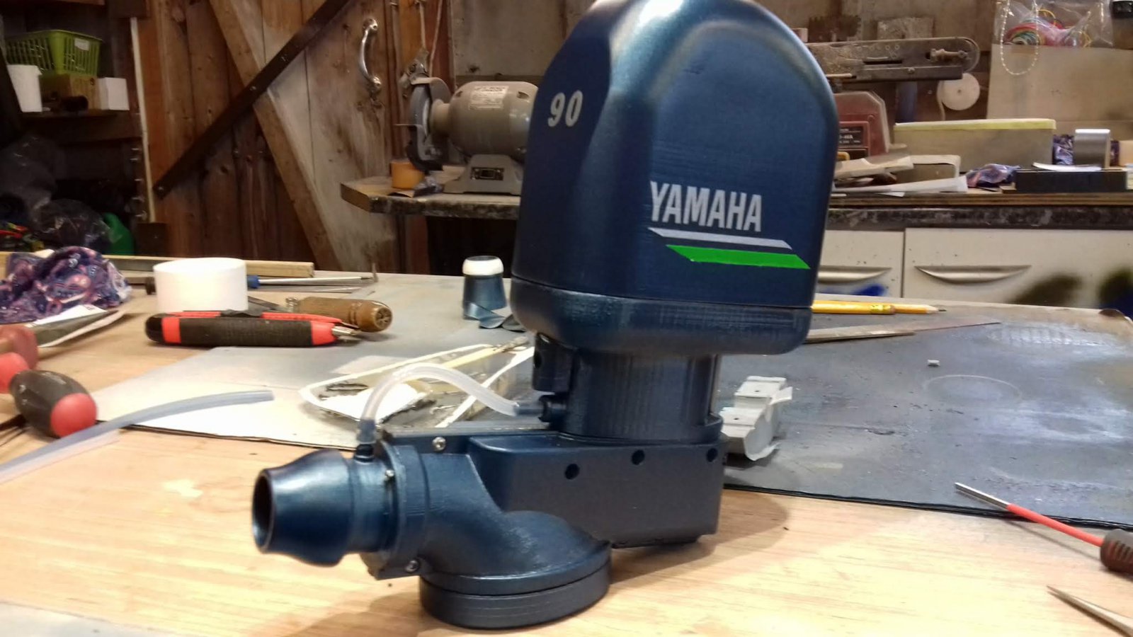

    20220725_151721.jpg 20220724_203243.jpg 20220725_151108.jpg 20220725_151052.jpg

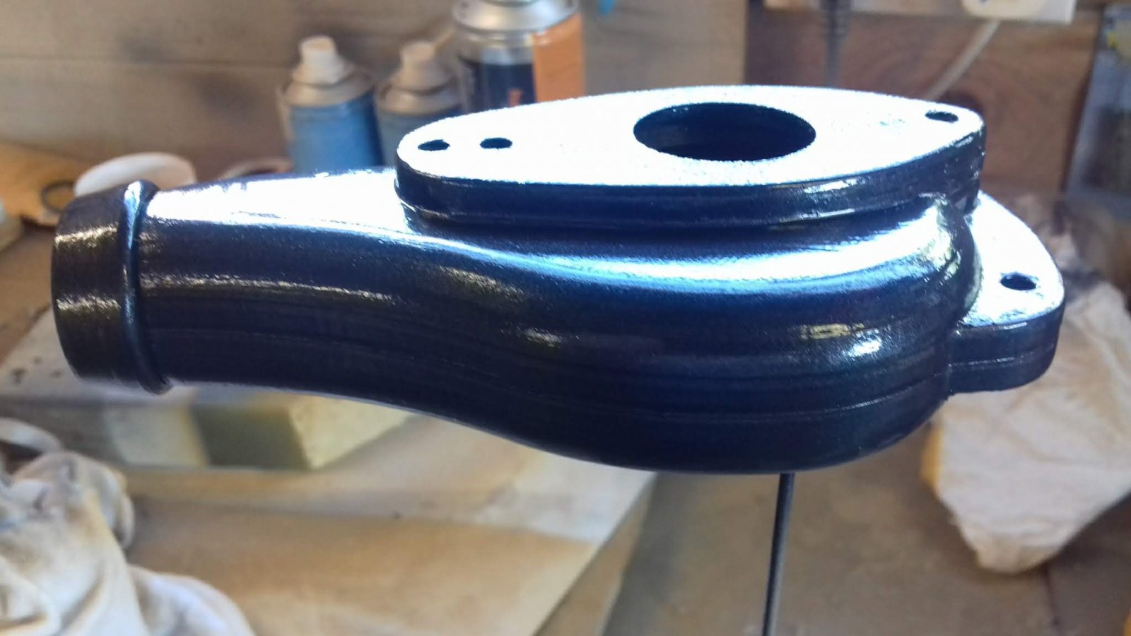

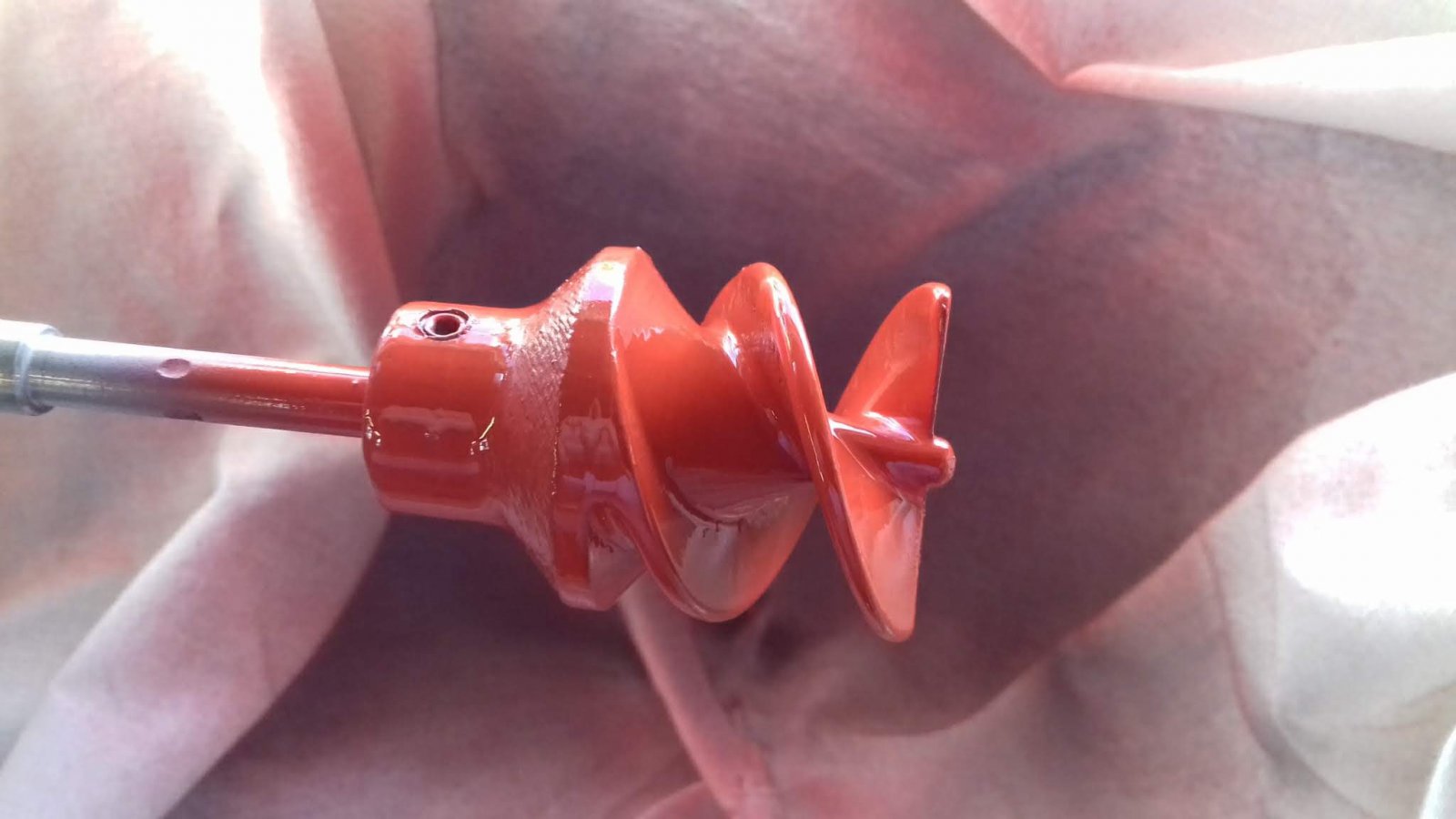

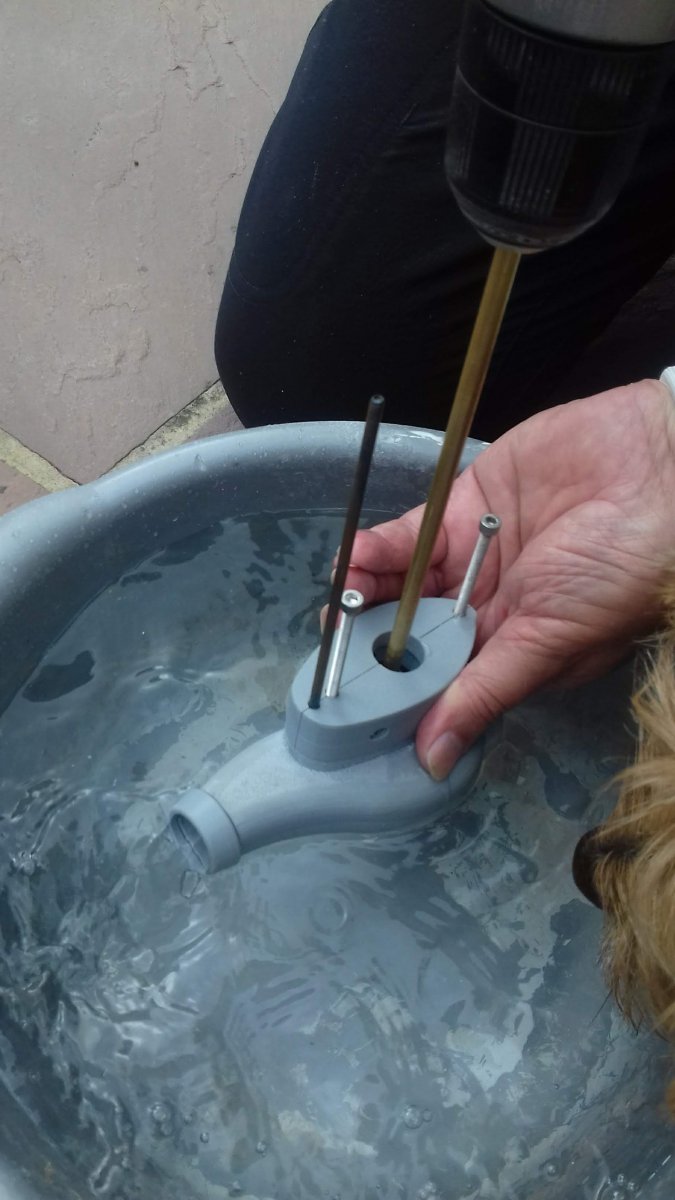

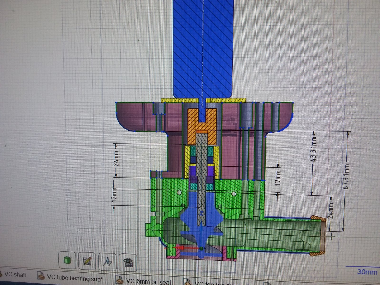

    Following close behind the V C jet outboard

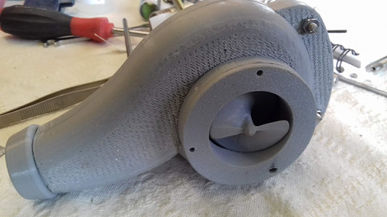

    Great progress today with the V C jet, I even ran it in a bowl of water, see photo, it was meant to be a video but that's what happens when you ask the wife to help At this rate it's going to catch up with the fox jet, I won't know which to test first

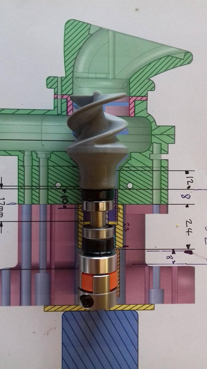

    Now I need to draw the pick up foot, That ring on the exit is a nice fit it really pulls things together and as it's a tight fit I could leave it unglued then If I want to try a reduced outlet it would be easy to swap. If it works well , I can see me building more as they are a lot quicker than doing a gearbox.

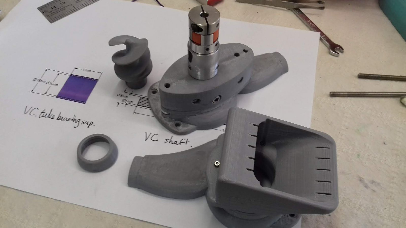

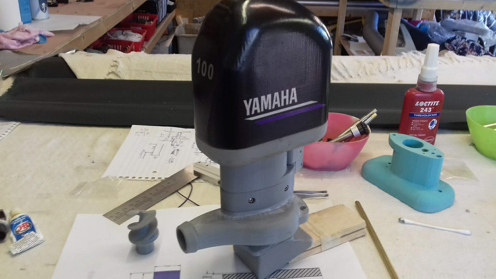

    Took the parts to the club today, there was a lot of interest and questions. Nearly ready to do some painting.

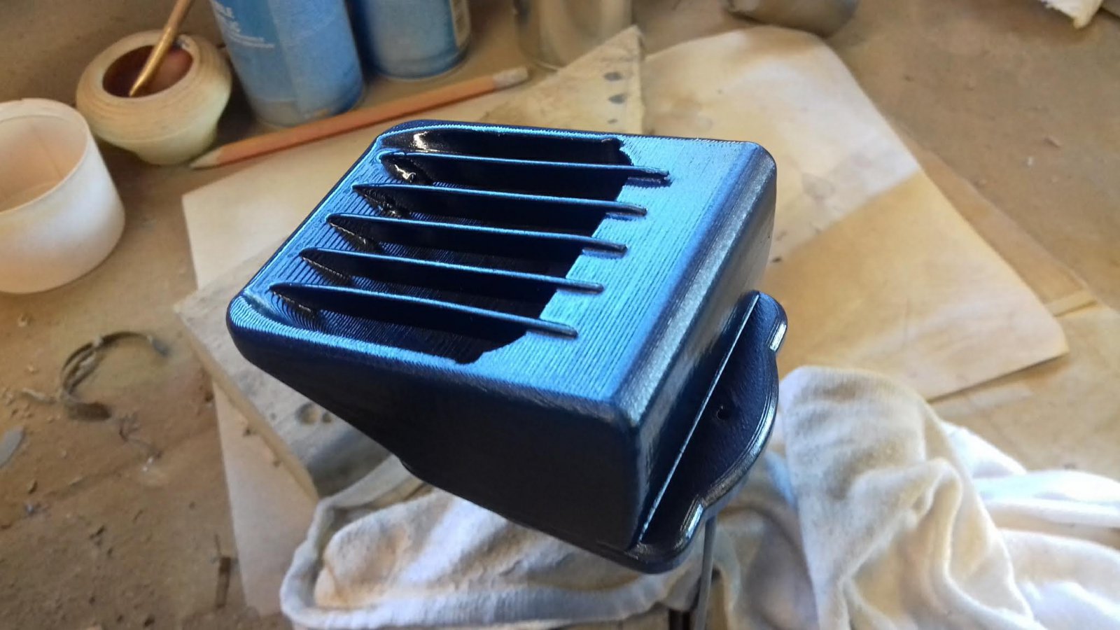

    This looks miles better than jet fox

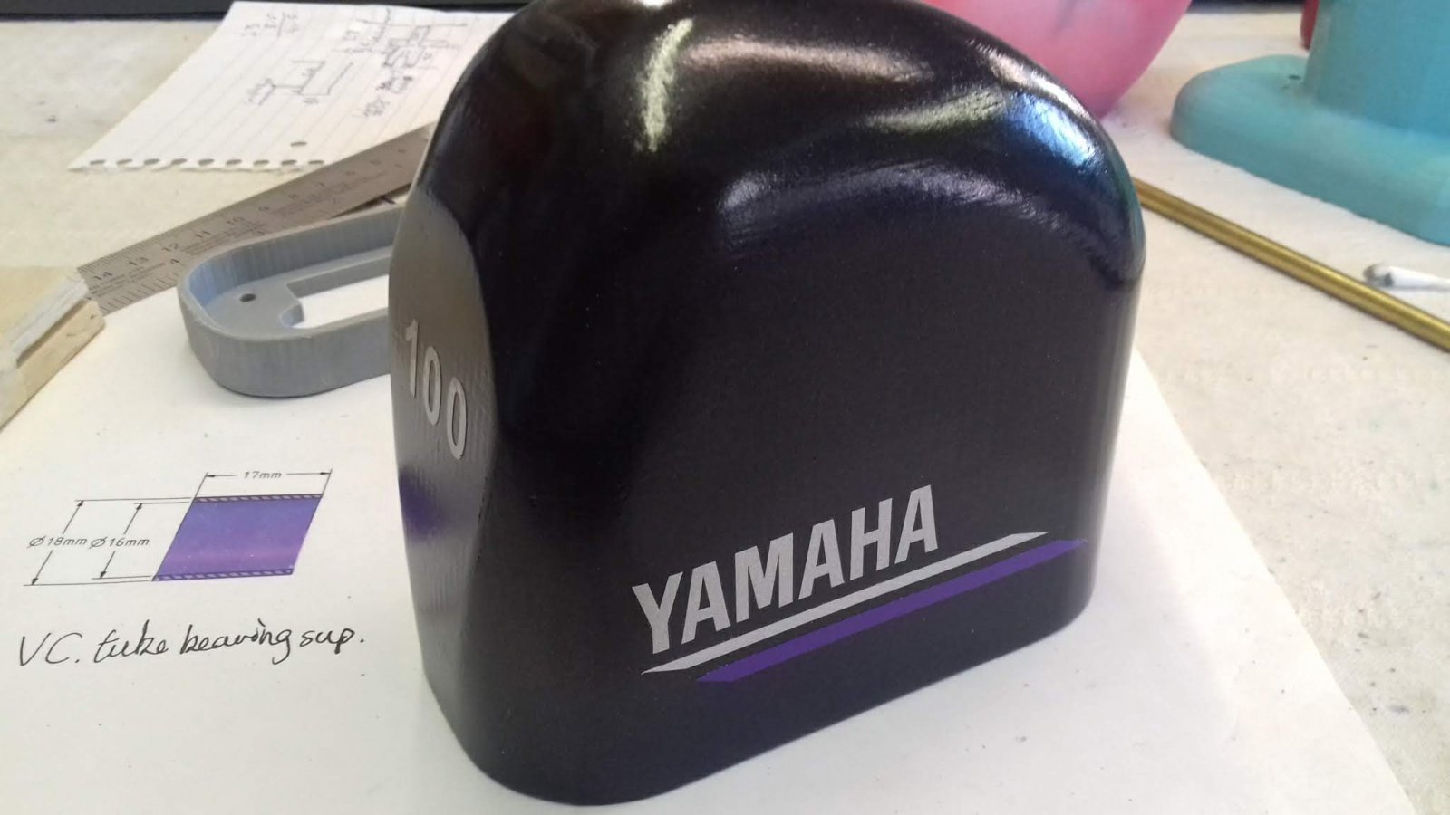

    20220805_173040.jpg 20220805_173106.jpg 20220805_174432.jpg 20220805_173142.jpg 20220805_173025.jpg
    Looks like a refund for the motor which leaves me stuck

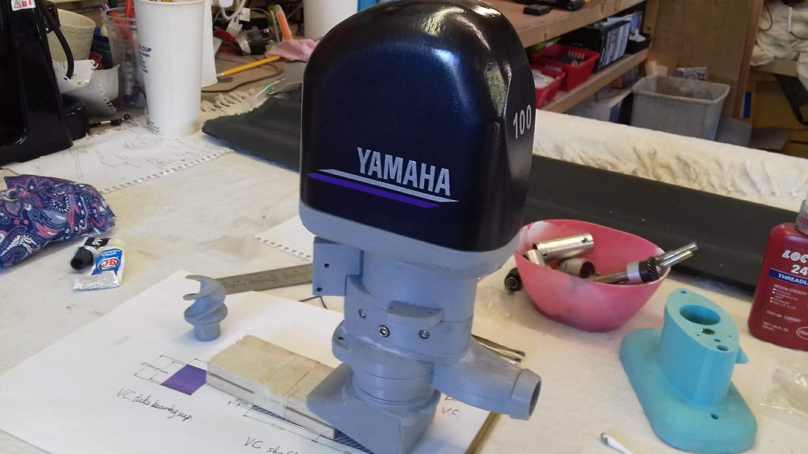

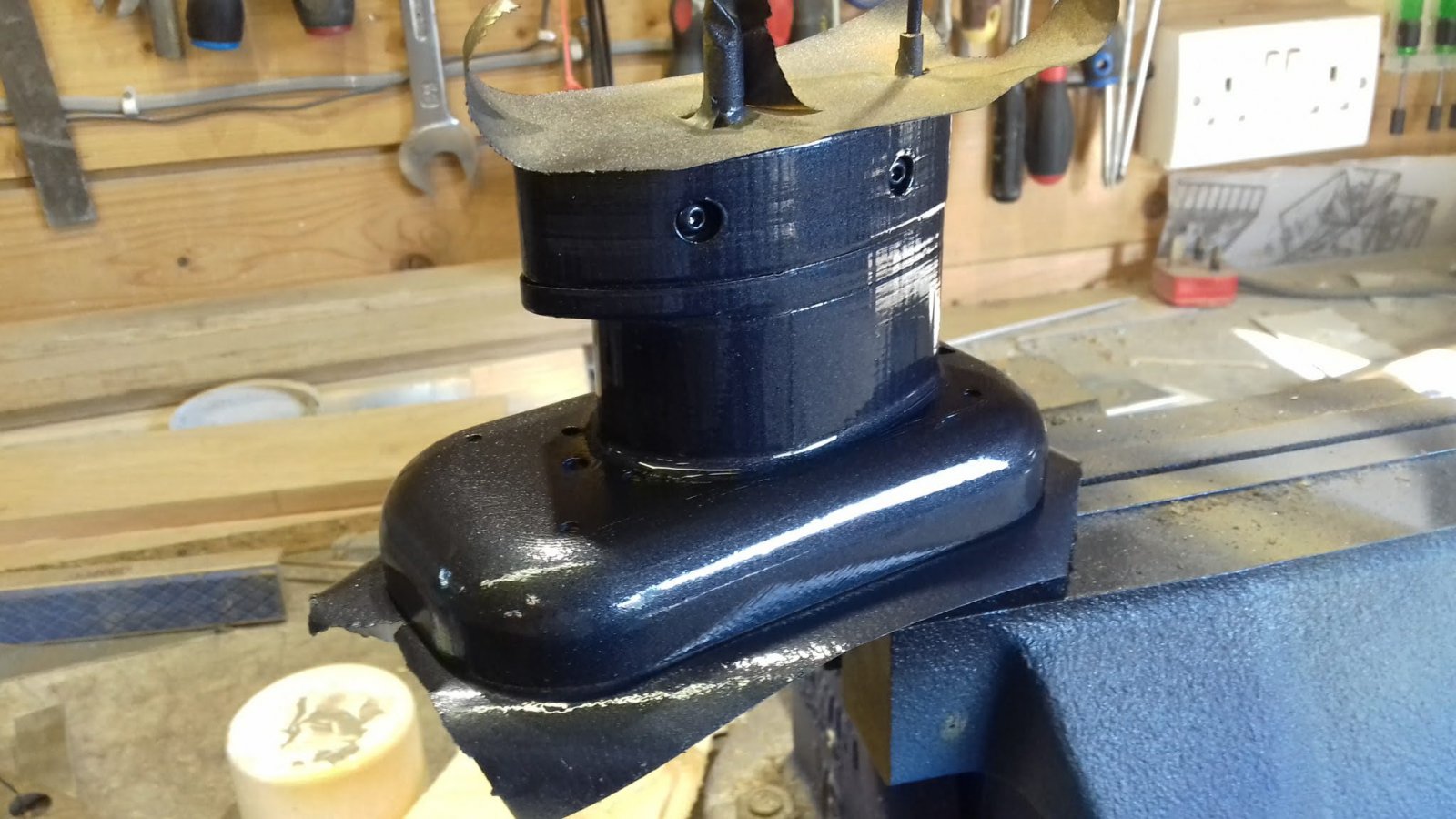

    Just printing some different size wear rings so I can find the best one to use. Not sure how to glue the chamber now it's painted it could spoil the paint. Shall I use cyano or epoxy? Epoxy gives me more time to line it up.
    Unusual RC vindt dit leuk.
  17. Unusual RC
    Unusual RC
    19 mei 2004
    1.765
    Rijswijk, Zuid Holland
    CA can ruin the paint due to the white wash, so I would go for epoxy!
