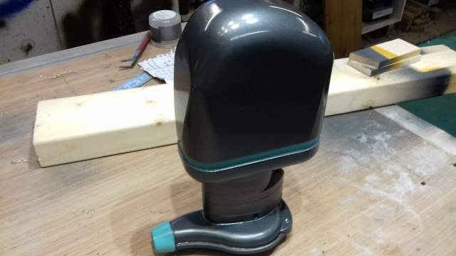

    small.jpg quite pleased with the finish, just waiting for motor coupling now.

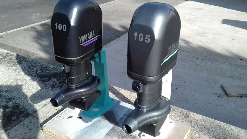

    Here she is Yamahas top of the range 105 hp at the pump, driven by a 150hp engine.
    Tomorrow is test day, video will follow, hope its good.

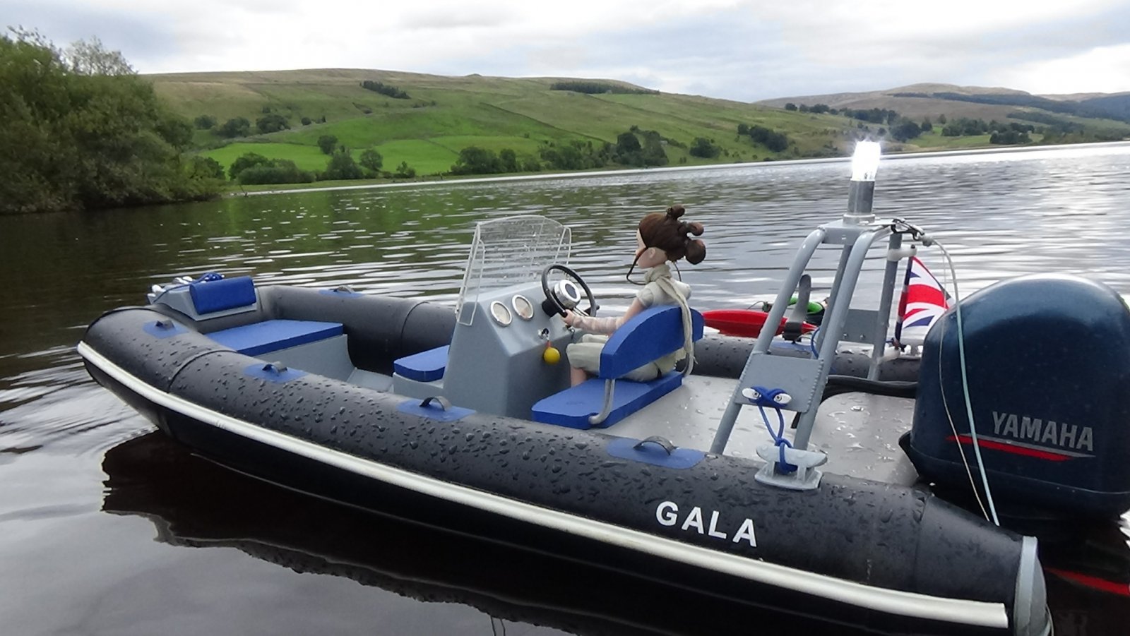

    Had a great afternoon, boating and kneeboarding in beautiful surroundings. We are in the Yorkshire dales again in the same place as last year. The lake was flat calm, i should have had a film for u tube, but the camera let me down. It caused some interest with people getting phones out to film it, even noticed a drone flying over the boat, wish i had that film.
