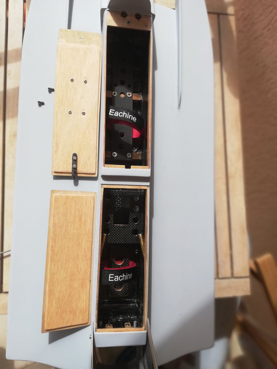

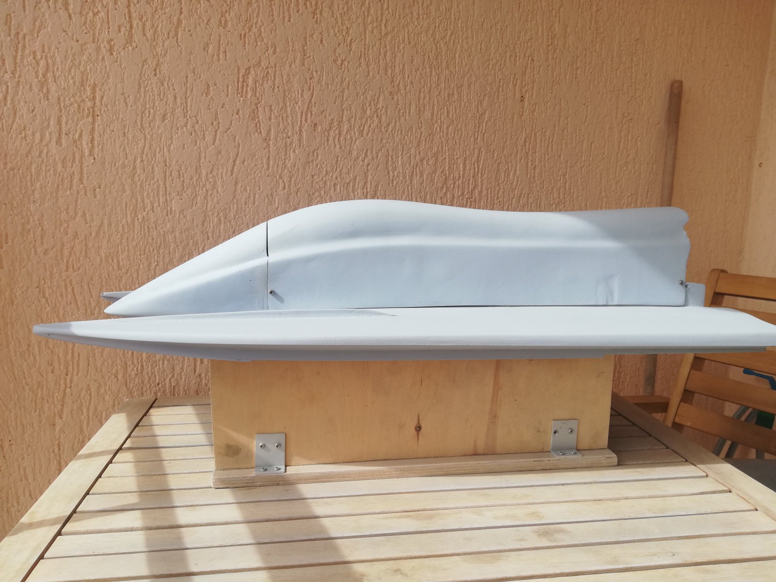

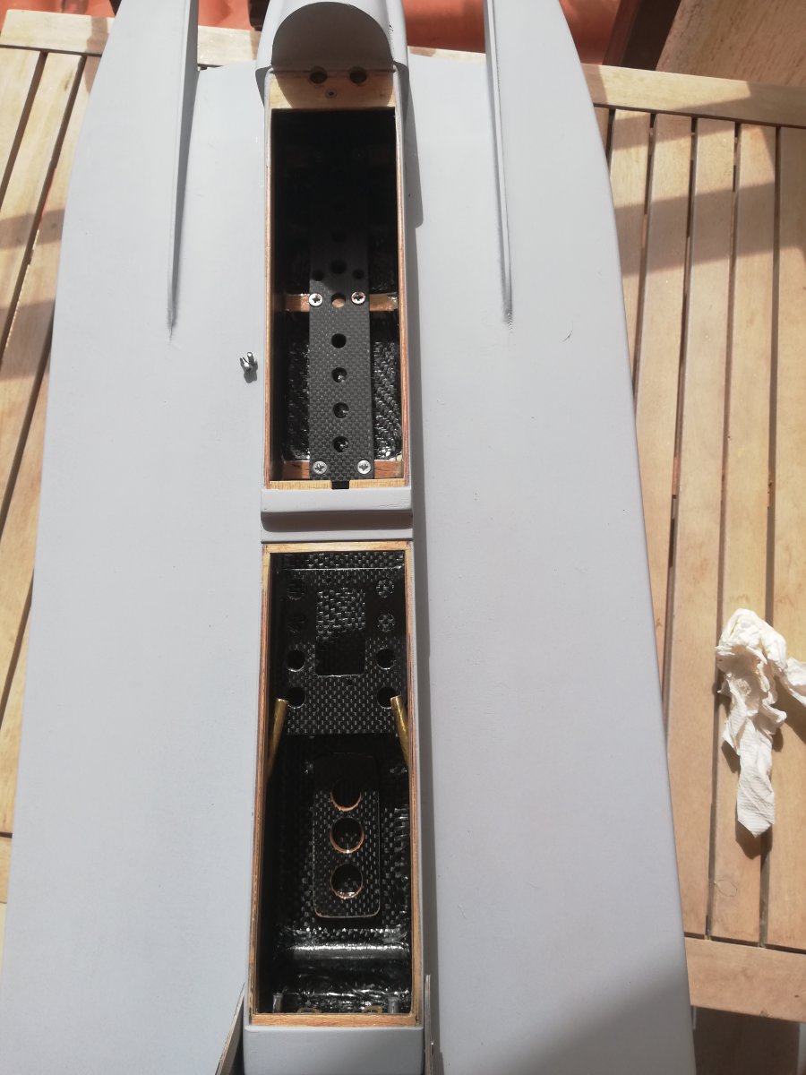

    Finally, some primer on the hull...
    The new cowl is almost 60 grams lighter than the old one (150 vs 208). I use screws (they will be replaced by thumb screws) to secure the cowl on the hull.
    The servo and esc mounts are also glued and the radio box is slightly laminated again with a light epoxy resign.

    Very neat job, I'm very curious about the paint scheme!
    Also, you managed a good weight saving with the new cowl

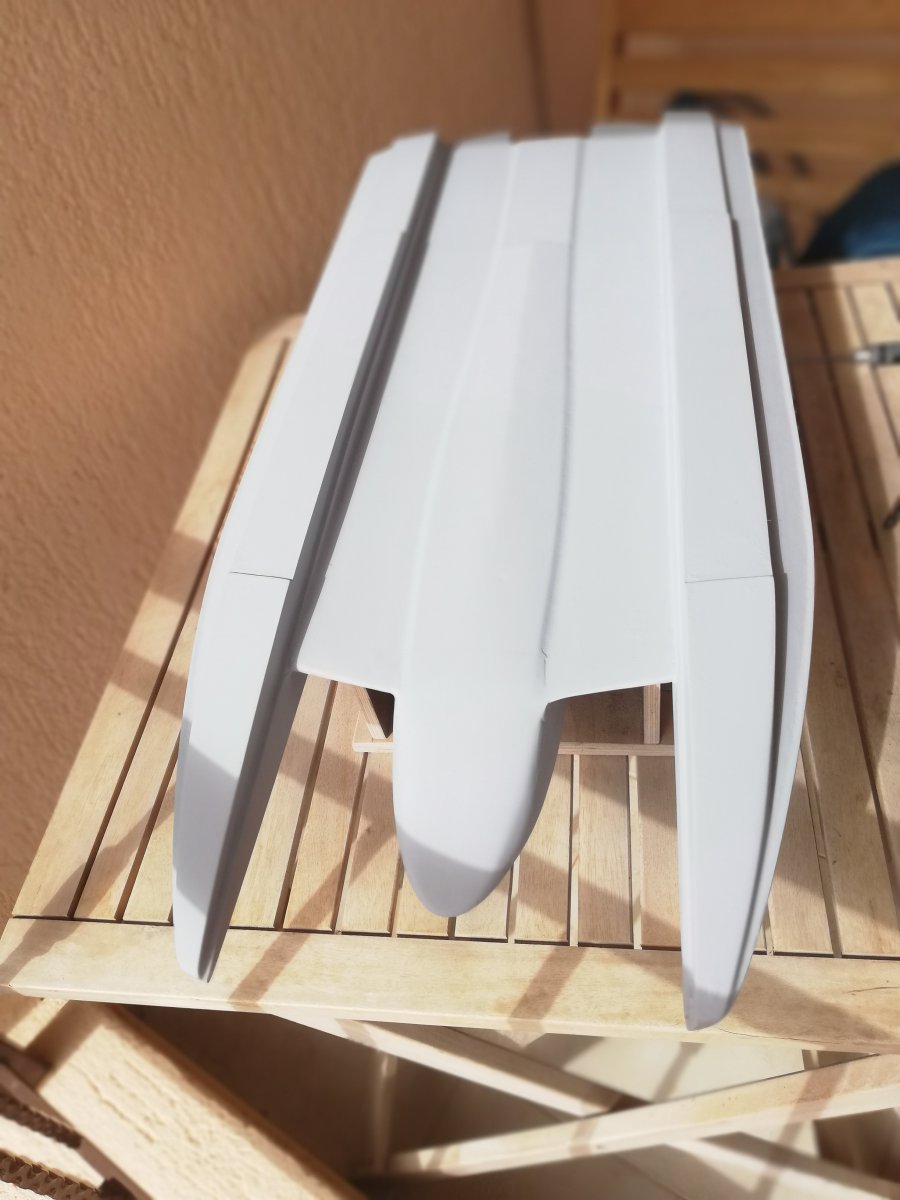

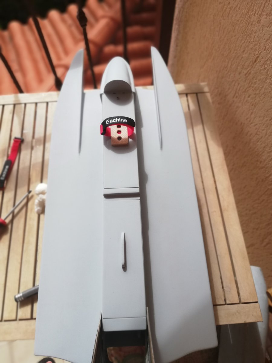

    Thank you Jan!
    However, It still needs multiple circles of putty and sanding to be really smooth!
    This time I will go for white, fluo yellow and light purple details. But I am still not 100% sure!

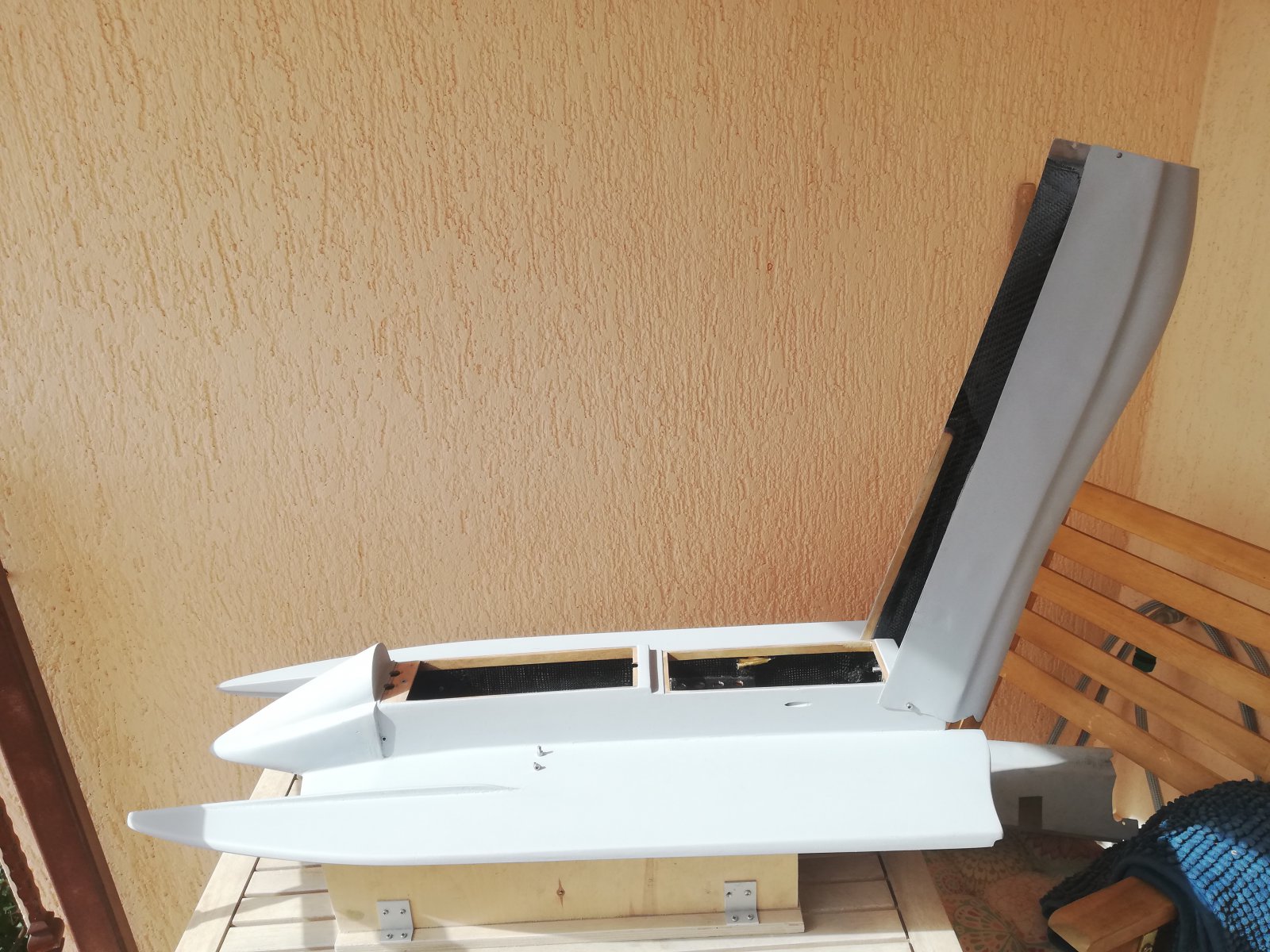

    Edit: you are right Jan I don t have a cowl yet. I have problems fitting the cowl on the hull with a functional and beautiful way due to the incorporated front end of the cowl on the hull. It needs more work for a nice result and probably some changes in the current design.

    I'm curious about your cowl issue. Maybe we have an idea how to solve it.
