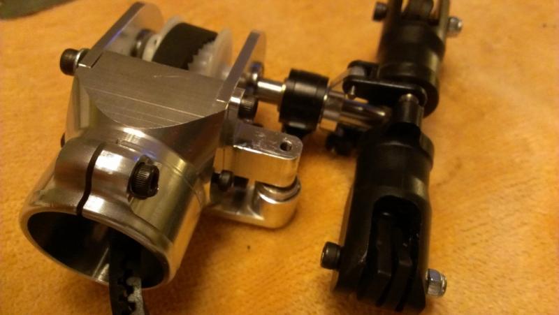

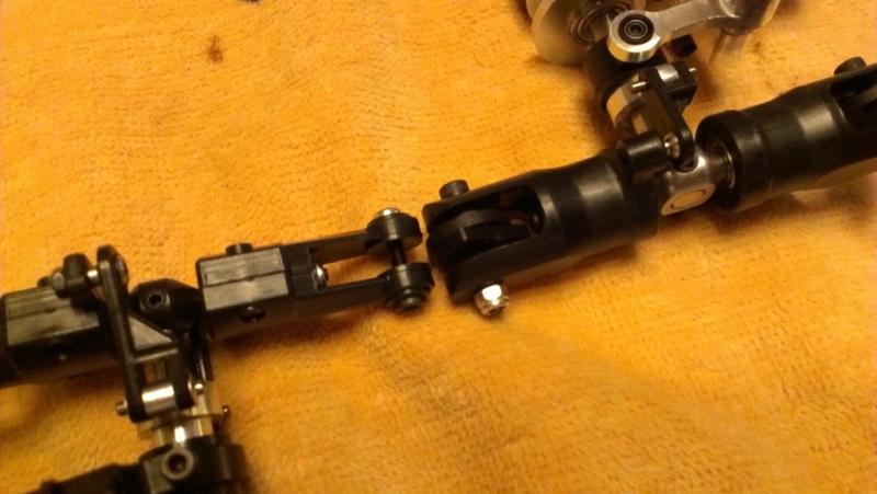

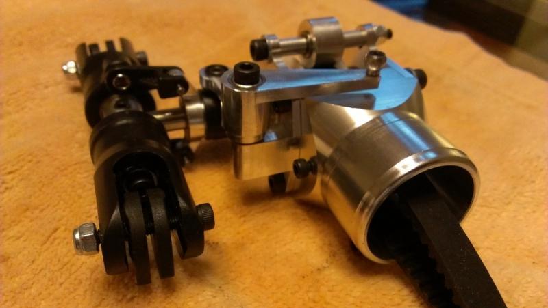

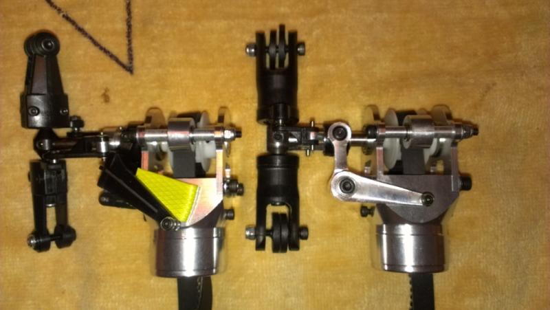

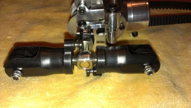

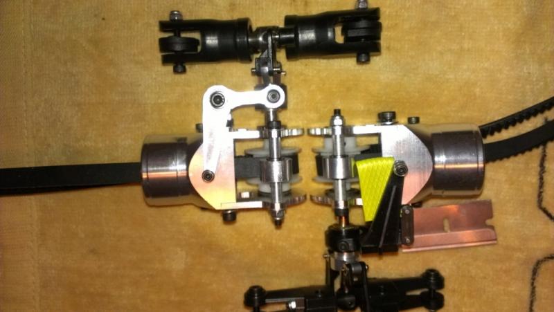

Hier nog wat foto's van de nieuwe tail :
(bron : More Pics of the New 7HV Tail Assembly!!! - HeliFreak)
full
full
full
full
full
full
