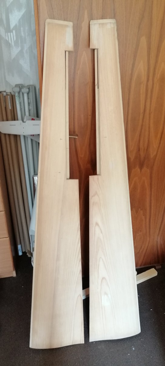

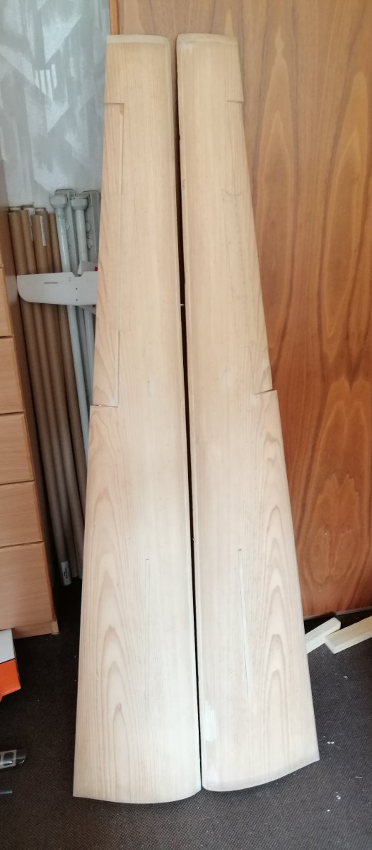

i have bought a bundle of RC planes and stuff.

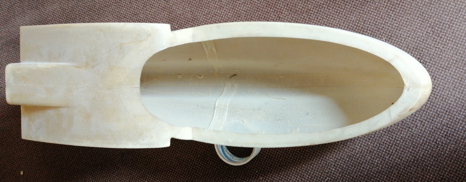

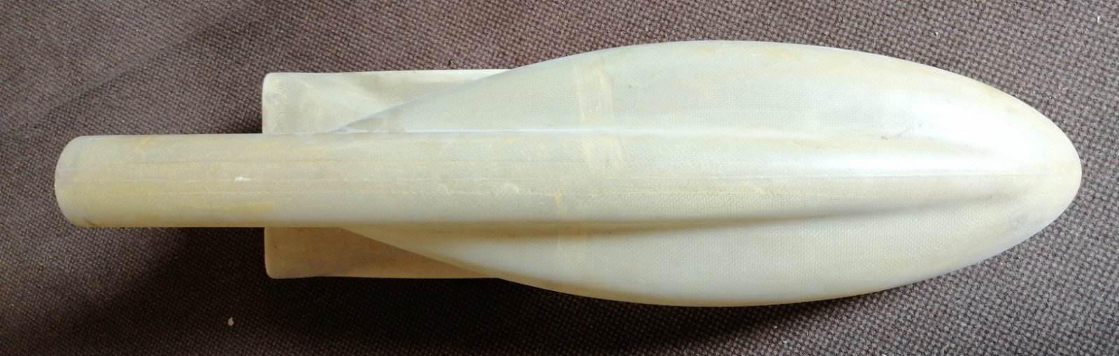

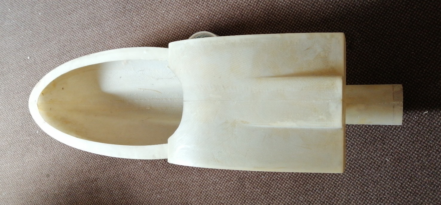

And there is a front fuselage and the wings for an Robbe Ogar. Not buildt, no damage.
Someone on RCN (i can tell the nick) could produce the deep-drawn parts of the cowling and the canopy.
So if someone here is interested in these two Ogar Parts (wing and front fuselage)...call me.

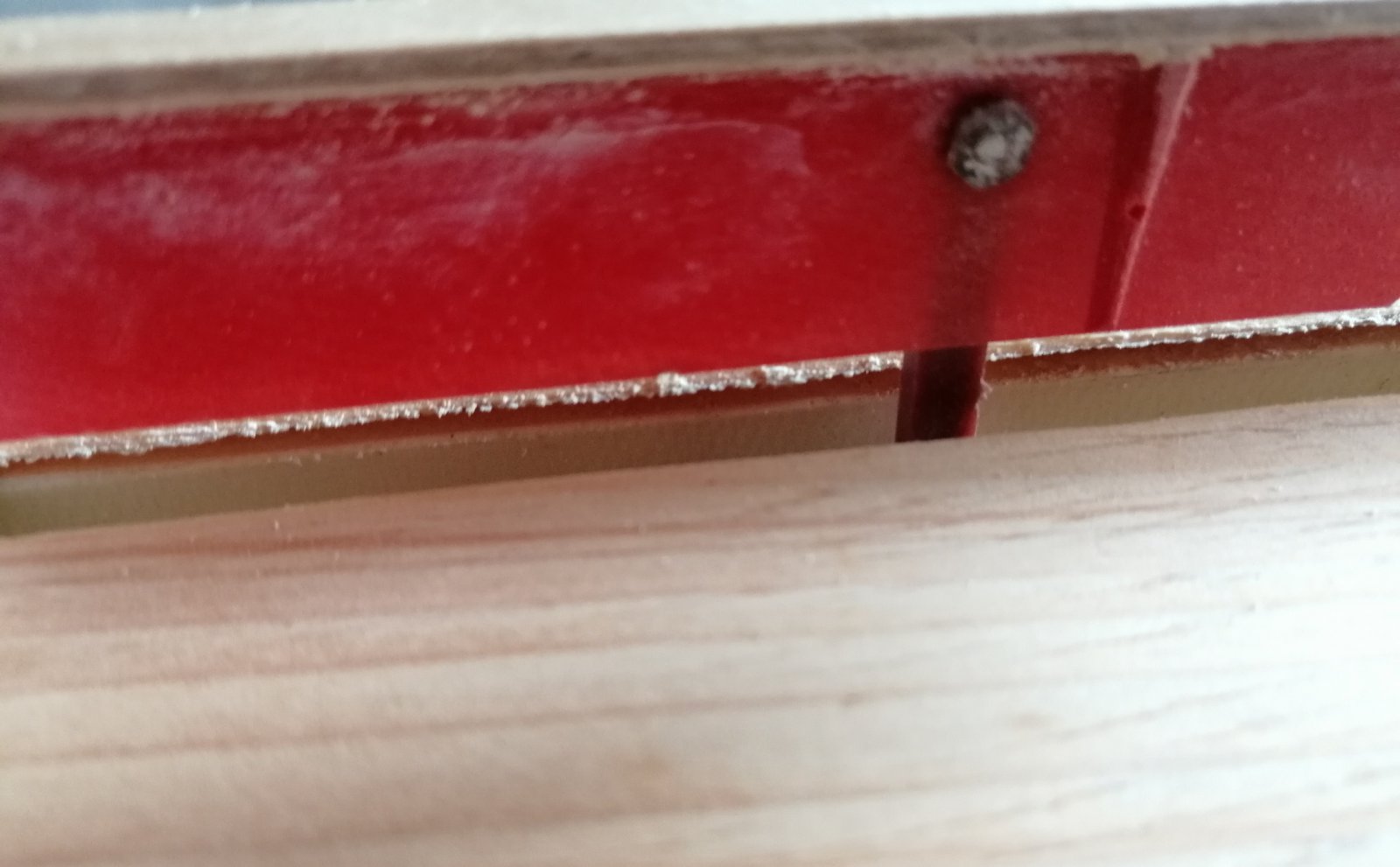

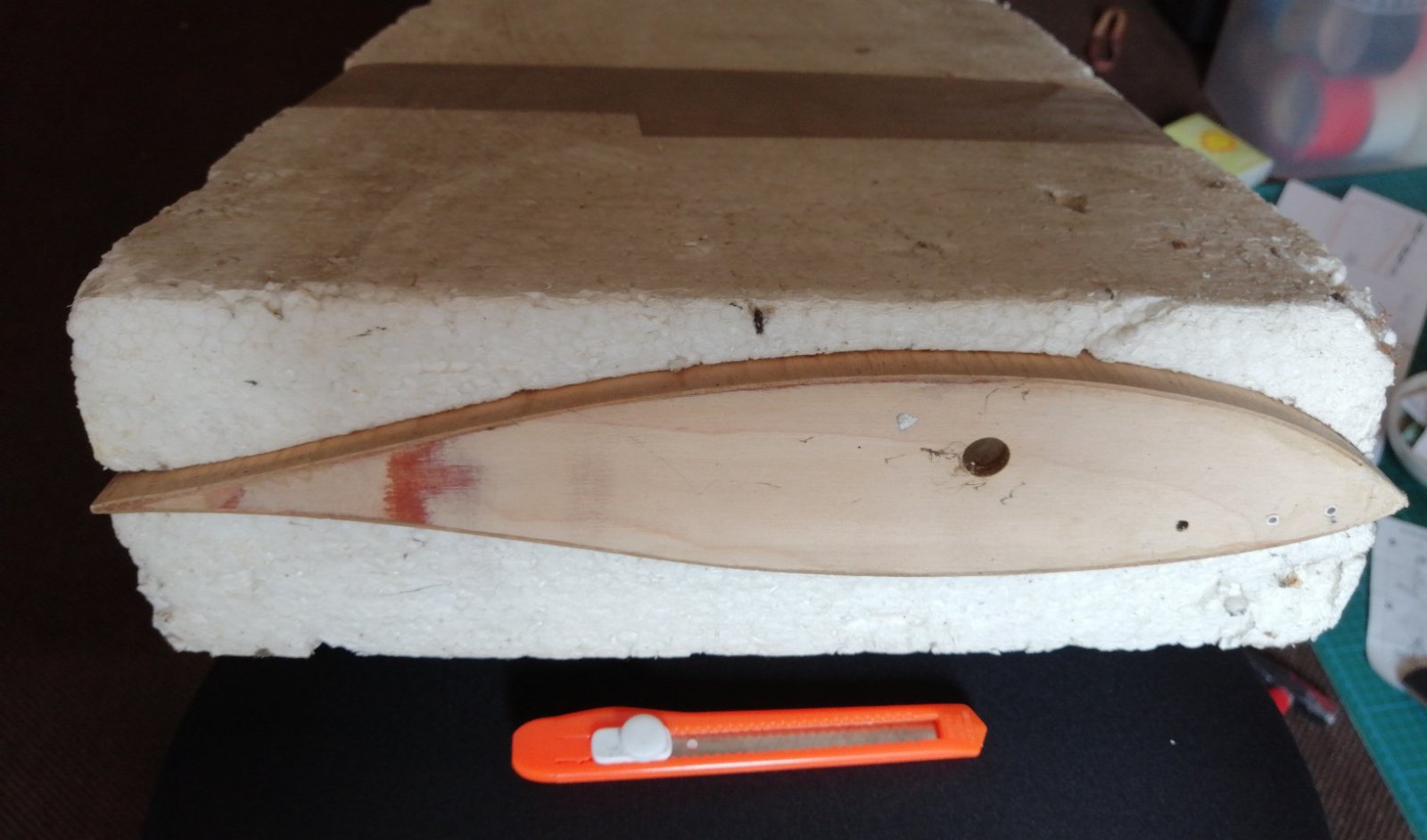

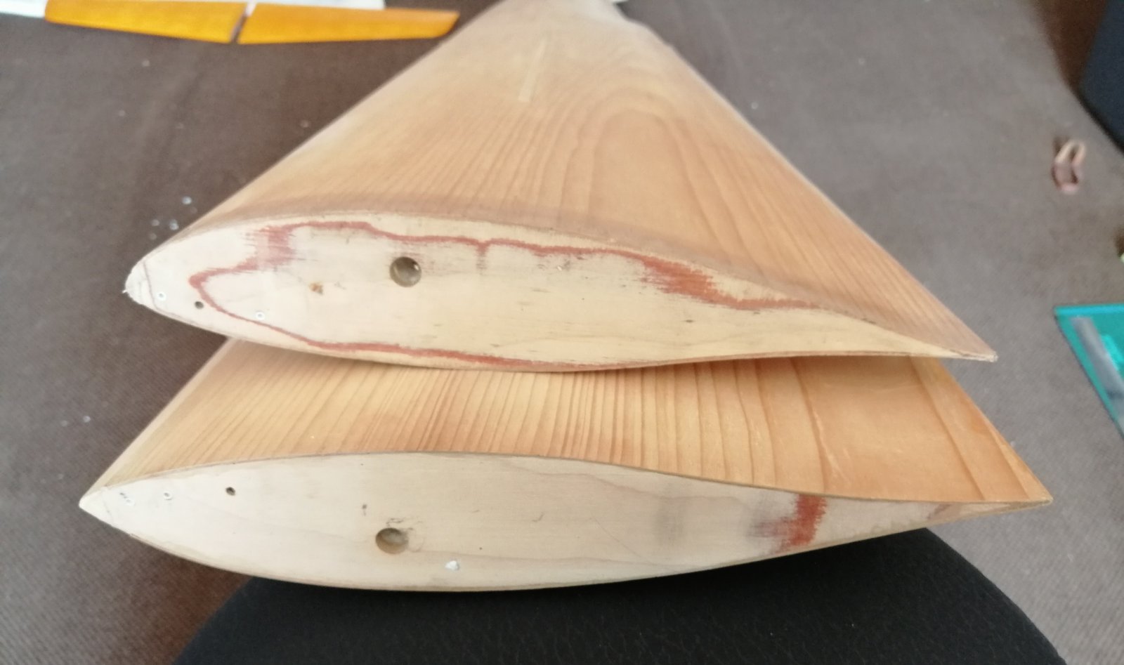

I think the wing is not original, because the planking is not out of abachi, it looks like pine wood.

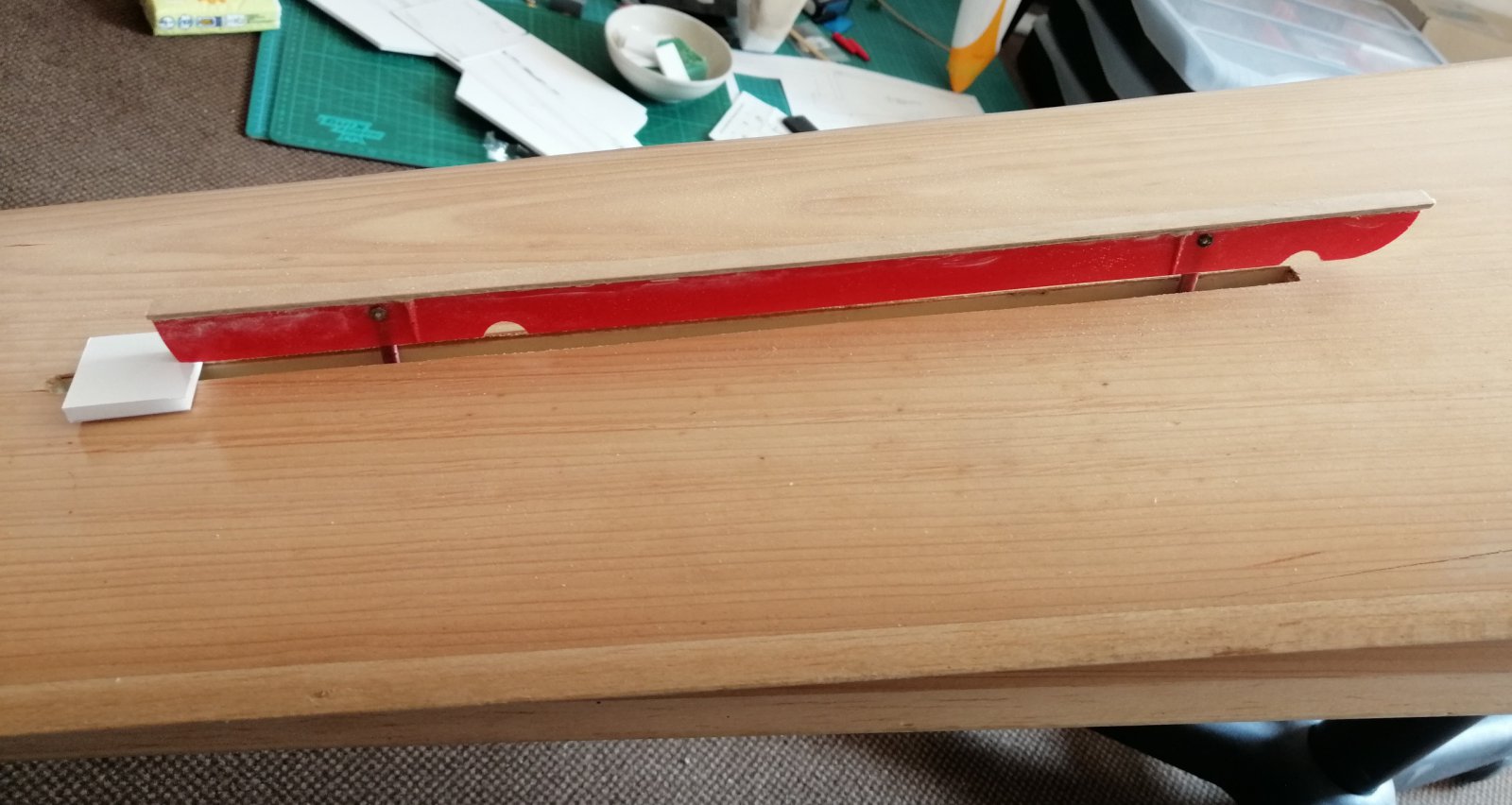

But they are well made, not heavy and stable. Both with spring loaded airbrakes/spoilers.
On one of the wings the planking has detached before the spoiler and behind. But the spoilers are sitting in a kind of frame, so gluing back the planking to the frame....littel bit grinding...done.
They are indeed not original, as the originals were all wood fully sheeted rib construction, and these ones are sheeted foam.
But that does not have to be a bad thing...
Oh, thanks for this info. Somehow i thought the originals were foam/abachi.
I build models since 35 years, so i can say this wings are really well made, and as already sayd they are light and strong.
