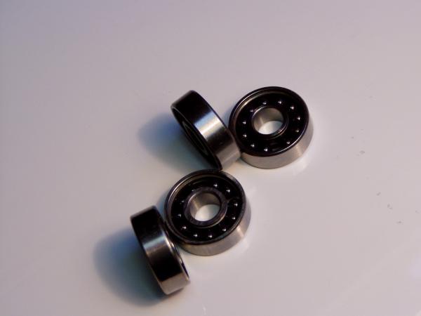

  18. G J Broekhuizen
    G J Broekhuizen
    Lid geworden:
    12 jul 2004
    Berichten:
    1.397
    Locatie:
    Elburg
    ball bearings
    for testing skates bearings ceramic balls innerring adjusted for 11 balls.
    [​IMG]
    if it is good I use grw 608 the preload must not be too high.
    [​IMG]
